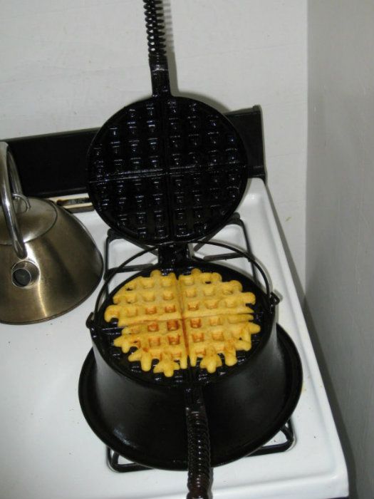

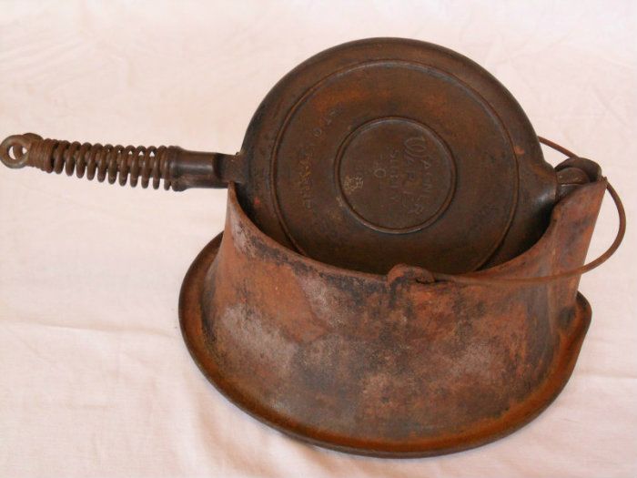

Last year I started collecting and restoring old cast iron pieces. I have gotten a little insane about this. Old cast iron is MUCH different than new cast iron, the iron itself is different as are the methods used in the casting. Older pans are much thinner and lighter, but the metal is more dense and glossy-smooth which creates a beautiful non-stick surface if you season it properly. For restoration, only if you're totally nuts like me, I use the electrolysis method, also known as the mad-scientist method. Here's a youtube video that demonstrates: https://www.youtube.com/watch?feature=p ... XlsNucmbiE Basically you submerge your piece in a tub filled with water and a little washing soda (to increase electrical conductivity) along with a sacrificial piece of metal that doesn't touch your pan. Then you hook the black end of a car battery charger to your pan, and the red end to the sacrificial steel and let it cook for a few days (depending on how strong your charger is and how bad your pan is) This method strips off absolutely everything that ever touched your pan, including rust, down to the bare metal like it was brand new from the factory.
Then I re-season using the flax oil method - you need multiple VERY THIN coats for this to work properly. Here's a before and after of an amazing old Wagner cast iron stove-top waffle iron from the 1920's that I restored.
The super-shiny blackness isn't oil on the iron - it's dry to the touch. It's how your finish looks after you've seasoned it really well using many super-thin layers of flax oil.
In maintaining your pan some of your seasoning WILL come off over time - the idea is you're basically continually adding thin layers of seasoning every time you cook just by virtue of the oil you cook with and rub the pan with when you're done (which then gets heated and cooked on with subsequent use) - just make sure any oil you're leaving in the pan when you're done (no need to limit it when you're cooking) is a very thin layer. Rub most of it away with a paper towel. Too much oil left in the pan leads to goopy uneven layers of seasoning that break down and flake off over time. This additional regular seasoning shouldn't be flax oil by the way - just your normal cooking oil. Flax just gives you a really good jump-start on the process for your initial seasoning. I usually add a few more layers of of flax seasoning a couple of times a year as a tune up.
As for care, I scrub with a nylon scrubbie with water, I only use soap rarely but it's not the end of the world. If something is really stuck on, which doesn't happen too often if I'm taking good care of my pan, I scrub with oil and salt and then rinse with water, or if there was a major accident, I simmer the pan on the stove with some water, then do oil and salt. My pans always get dried over the burner until there's no trace of water, then rubbed with a tiny bit of oil - I rub off all the excess with a paper towel. It sounds like it's a lot of work, but it's not at all. It's just different until you're used to it. And remember, many of these pans have survived for a hundred years or more ( I have a griddle from the 1890's) - they're very tough and forgiving and you can fix almost anything you do to them so long as you don't let rust eat holes in them.

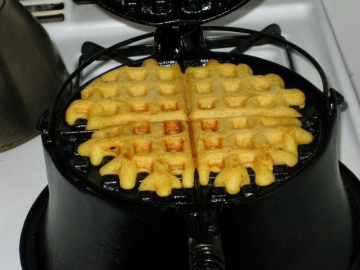

Thanks guys! I posted that one because it's the most impressive looking in pictures and I'm pleased with the way it came out. I love pouring cornbread batter into it and serving crispy waffley triangles poking out of a bowl of chili.
I will say if you're interested in buying a more simple cast iron skillet, I recommend going with an older one, rather than a lodge. They're just better quality, but you do have to clean them up. They really end up costing very close to the same if you're just looking for one for every day use and not something fancy and rare to display. I have good luck on ebay and if anyone is interested, I can tell you what to look for.
If electrolysis is too extreme for you (it's fun and not hard, really! if you have a car battery charger already, you're halfway there), some people have good luck with using the self-cleaning cycle on their oven, as someone else mentioned. You risk cracking or warping your pan, though many people seem to use this method without a problem. Some people also use oven cleaner, I just don't like the chemicals on something I'm going to cook with but many people don't seem to mind.

Cornbread in a waffle shape - genius! That is so wonderfully impressive! (Your cast iron waffle maker, I mean.) Super great job on that. I really love your enthusiasm, and now I think I'm gonna go rescue my cast iron pan that needs some love.

That may totally have been what happened, but it could also have been an accident where someone left the dry pan on the burner for too long and forgot about it , or maybe even a casting flaw that was accentuated by excessive heat over a long period of time. It's one of the things that you look for when you buy old pans - does it sit totally flat on a flat surface, or does it rock a bit. I've walked away and forgotten about a pan I was heating to take the water off - fortunately not for so long that it ruined the pan or burned down my house, but I can see how it could happen.
Thank you for the compliment on the waffle iron. One of the things I love best about it is how neat and functional and brilliantly simple the design is. The two halves of the cooking portion of the iron (as opposed to the base) are not connected in any way - they rest securely in the little ball joint on the base and then spin to flip the waffle, but pull apart totally separately for cleaning. SO MUCH EASIER than cleaning a waffle iron that's attached to electrical parts and can't be taken apart or scrubbed. I can just take this to the sink. There was a bit of a learning curve in figuring out how hot it needed to be and how long to preheat it and such, but like anything in the kitchen you get a feel for it and then it's like second nature. And my god, you have never had such a crispy-on-the-outside moist-on-the-inside waffle from an electric iron. You can't beat cast iron for a great sear or delicious crisp crust. Those of you that have had cornbread from a cast iron pan know what I'm talking about.
Thanks for letting me geek out guys!
